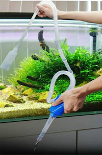

You can properly clean your tank by using a siphon to empty waste and debris into a bucket.
We call this a “water change”, it’s not a good Idea to take more than 20% of the water on an average change. Smaller tanks need more assistance since they have less of their own ecosystem, so for a 10 gallon you can perform a water change once a week or so.
